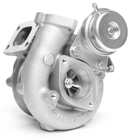

No cant use a stock turbo rear housing, has to be a 2860RS ( disco) or 2871
But can pick up a dead one for 50-100 then super core only 1300ish so stiull a cheap GTX than buying one off the shelf

I'm talking this style of turbo inlet/outlet vs this kind with a bolt pattern

THe GTX dont come in a s15 style bolt housing unfortunately so will have to mod your piping. Not to hard to do with silicon joiners to mate up to current piping as done it in the past with an old disco, but this time I was getting custom piping so just had it made to suit

#29 s15rocket
  • Joined:26-November 11
  • Car:180sx type x
Posted 17 October 2017 - 11:14 PM
Found an American company that makes the new gen 2 GTX turbos with S15 bolt pattern. :D
Plug and play boys! No mucking around with intercoolers or silcone joiners or v-bands.
Need to save us for this now. I wonder how the GTX 2871r would go?
My theory is to run the gen 2 GTX 2867r on e85 on my 180sx without having to install cams or springs (saving a lot of money) and should net me a nice 260rwkw on my stock unopened engine. :D
How you ask? There is a type x 180sx in the turbo reference guide (most recent page) with this turbo installed on BP98 getting 230rwkw without cams so I'm guessing on e85 its good for another 30rwkw.
What you think?
http://www.atpturbo....egory_Code=VSR2
APPLICABLE GARRETT PART NUMBERS:
* 849894-5002S
The GTX2871R features an ultra high flow compressor wheel and Garrett 11-Blade technology. 560HP potential flow.
The Garrett GEN2 GTX2867R features an advanced ultra high flow compressor wheel which supports up to 550HP potential flow.
Edited by s15rocket, 17 October 2017 - 11:21 PM.
